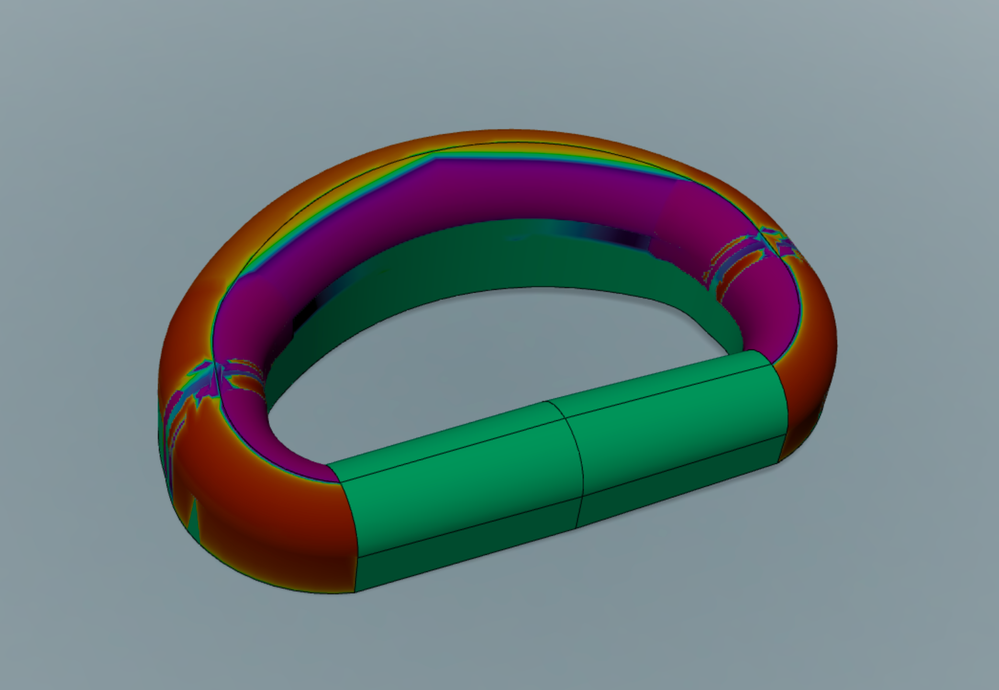

Hi all, I'm new to fusion 360, not so new to Autodesk and other CAD software.
As part of my learning curve, I want to design a showell handle. Kids broke it, so let's print 🙂
I wanted to make it a bit more complex, so I used a centerline with 3 different profiles and used Loft - centerline.
That went all good, but now I want to make it hollow. Yes I could make a offset body then subtract both. BUT I want to use the SHELL function. Not sure what I'm doing wrong, but it just doesn't want to work.
Any help would be much appreciated.

Here is you model with a 3mm external thickness.  Slide your timeline marker back before the applied fillets to add the shell.

Your model had a very uneven bottom so I dropped back to your original model and straightened that out.  I then shelled it and removed the bottom.  It is all explained in the Screencast.  I removed all your fillets as the ones on the bottom edge had to go anyway.  As I mentioned in the video, I changed the color because dark blue is hard to work with and see edges.  You or course can change it back.  Model is attached.

@jhackney1972 thanks a lot. Now I get it. I made it uneven when I played around with that first extrude of the Sketch 5 when I made it a bit Tapered. Thanks again John, you helped me a lot.

One reason shelling an object often fails is bad surface curvature. There is a curvature map inspection tool in the Inspect menu, which in this case perfectly highlights the less than ideal quality of the loft.
I personally would likely not have pieced this together from arcs and lines but used a spline as the rail:
