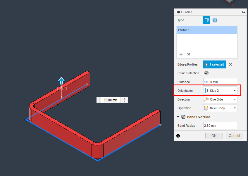

Hi im bending 5mm flat bar mild steel into a 300mm id square shape.
it came 304mm instead .
how can I change this to match my bending tool to get 300mm ?
many thanks David

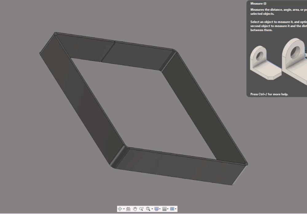

jhackney1972
Your model measures 300 x 300 mm inside already.  The Animated GIF will show this.
If this answers your question please select the "Accept Solution" icon on my post.  If you have further questions please ask.

HughesTooling
many thanks David
This would point towards the bend on the physical part being bigger than the modeled part. You could override the bend in the flange that created the bend and make bigger. Maybe measure the radius on the part you've bent and match in the model.

HughesTooling
I can't open your part at the moment because I haven't updated Fusion but if it's the model that's wrong is it because you modeled the flange to the outside when it should have been inside? You can change this with the orientation option.
Mark Hughes
Owner, Hughes Tooling

HughesTooling
hi thanks
any idea what I would change ?
thanks
The standard setting for the bend radius is the material thickness, so you could enter something like 3.0mm instead and try again. Also name the rule.
You're going to have to guess a bit about what rad you need, measuring the bend radius on a part you've bent might be a good start point.
Also if you hold down the Ctrl key you can select multiple edges so you can measure the total edge length, you probably need it to reduce by a couple of mm.
Mark Hughes
