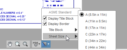

I'm having problems formatting the sheet drawing layout.
I need to place a model on 1:1 scale and I can't change the dimensions of the sheet.

Do you mean there's no sheet big enough or that you can't change the size after creating the drawing. There is an option on the bottom toolbar to change the size after creating the drawing.

Yes, It allow me to change the sheet format after creating the drawing.
However, the maximum size paper that allows me is the size A0... If I want to put one large model in the real 1: 1 scale, in this case, it is not possible.
