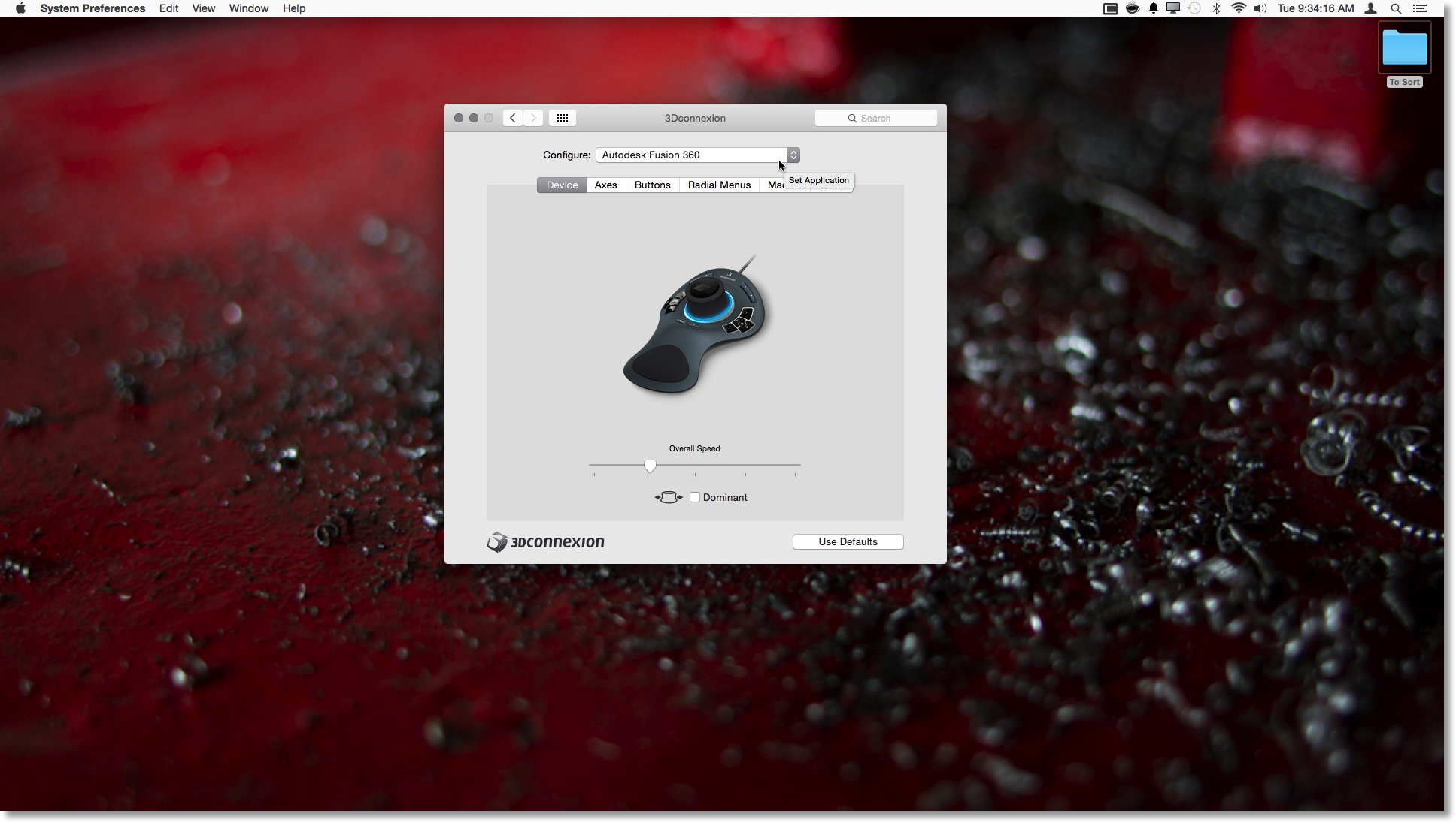

Launch the 3DConnexion settings. On OS X you will find these in the system preferences.
Select Autodesk Fusion 360 so that your are configuring your settings specifically for Fusion 360. If you make changes in Any Application it will change the settings across all applications and if you use multiple CAD tools like I do, that can be an annoying mistake.
