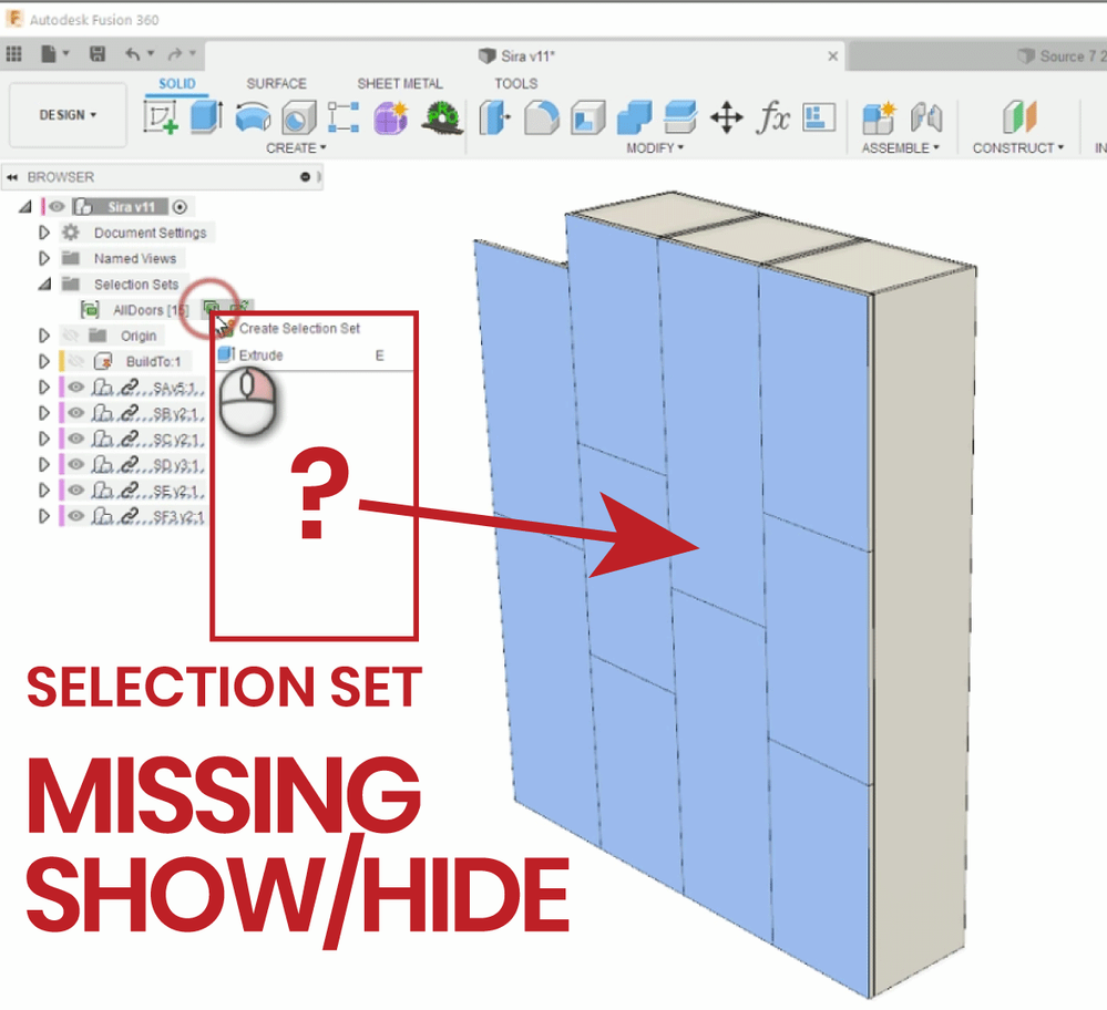

Hi @jeff_strater  and community,
We are working in the main assembly which is composed of external components. We want to use selection sets to hide some components to see inside the design.  The section set works great but is missing more options such as show and hide.

HughesTooling
For this to work with inserted components you need to select the component in the selection set, looks like you selected faces. If you set your selection priority to components, select all components as a selection set it should work.
Mark
