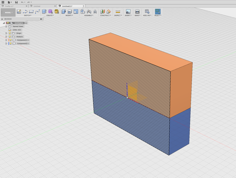

hi @HughesTooling,
I just tried your temp file and I'm not seeing the same issue.
What are your machine specs?

Do you have colour cycling enabled, it's only a problem with it off.

colin.smith
@HughesTooling No it was off.  I turned it on and off again but no difference.  Works as it should.

HughesTooling
The original file shown in my first post is displays fine on my laptop. I try on my work PC again tomorrow, probably find a reboot fixes it.

HughesTooling
Everything's displaying correctly today after a reboot.
