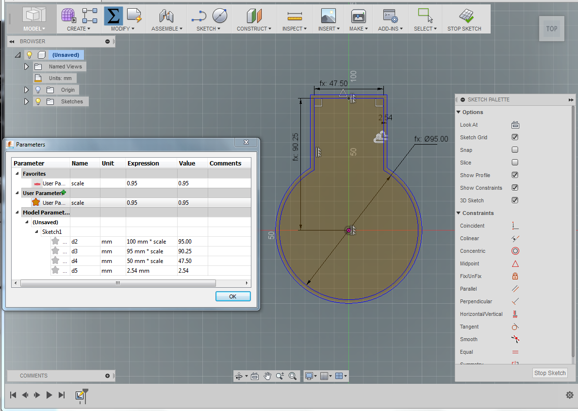

Im working a lot with offset in sketches to keep tolerances on my 3d printed parts.
So I sketch out something, add an offset of x, continue and then start finetuning an that includes scaling.
AFAIK I can only scale the whole sketch, that unfortunately means that my offsets also get scaled.
Is there a way to scale inside the sketch environment? I tried just selecting and dragging certain parts like eg a circle but that deforms the parts because I cant lock the dimensions.

There currently is no scale command in the sketch environment.
  1. I would suggest creating a unitless user parameter: Scale = 1
  2. Then for the shapes you want to scale, add this to the dimensions, like this: X.XX mm * Scale
  3. When you want to change the scale of the dimensions, edit the parameter for Scale.
I just did this in a couple minutes. It works well. NOTE: fully constraining the sketch is required.

Don, he means the sketch needs to be related to the origin. The example of the rectangle, a center point rectangle coincident with the origin amd that has horiz/vert conatrains on all sides or one side and perpendicular between all the others. This way the dimension change is conaistent.
For the challenge you will need to go to modify/change parameters. Your user parameter foe scale, lets call its ScaleFactor, has a value of 1.11. In your sketch when you dimension your length and height(lets say 10 & 5) you will enter "ScaleFactor * 10" for length and "ScaleFactor * 5" for height. You need to know the parameter name and its case senaitive I believe.

@dghylin Take a look closely at the screen shot I provided. In the parameters dialog I multiply each dimension by  the paramter Scale. So a vertical and horizontal dimension on a rectangle would both be multiplied by the same factor, and thus both change together if you change the value for Scale.
When I say "fully constrained" I mean that each line, arc, or circle is defined by dimensions or geometry constraints. If one line (in your question it would be one of the sides of the rectangle) is not dimensioned, and thus would not be multiplied by Scale, it would make a huge difference.
I hope this helps, let us know if you have more questions about it.
