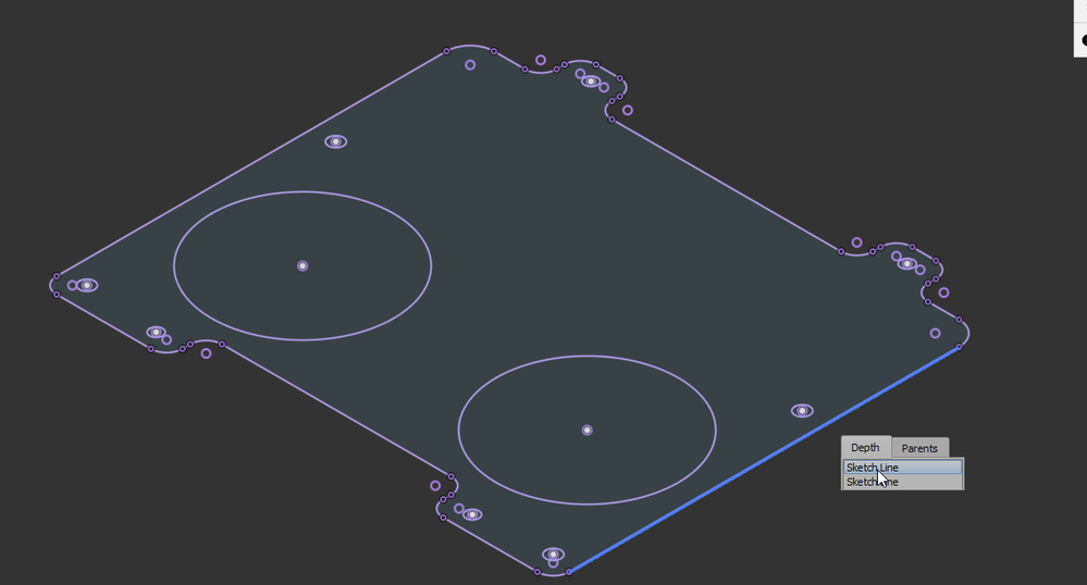

jeff_strater
I exported this sketch as DXF from the context menu on the sketch, and re-imported it into the same design on an offset plane, and I don't see any missing geometry.  Can you tell me what is missing here?

HughesTooling
One problem you might have is you have duplicate curves. You probably have auto project geometry on active sketch  plane enabled so when you select the face you get one set of curves then you've projected again.

HughesTooling
The duplicate curves were confusing ZW3d, after cleaning up the sketch in fusion and removing the copies I can import in ZW3D and extrude a closed solid that's the correct size so not a lot wrong with the DXF from Fusion.
