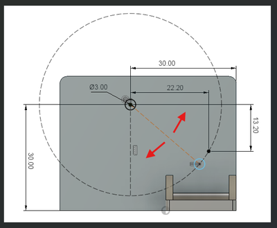

Still a novice and mostly using Fusion for 3D prints.  Currently working on a mount for a microswitch.  2 holes for the switch.  The second hole is displaced from the first by 22.2 mm lengthwise and 13.3mm width wise.
I have constrained the first hole to edges of the plate 30mm from each end and added constraints from the first hole to the second hole by the above measurement.
What I am trying to do is simply rotate the 2nd hole while keeping the first hole at 30mm from the 2 edges while keeping the 2 displacement measurements the same.  Doing this to fine tune the position for activation of the microswitch.  I tried editing the first hole and rotating it but that didn't change the second hole.  If I move the second hole I lose the displacement measurements.
Screenshot of project and Fusion file attached.

in certain circumstances, dimensions constrain themselves to measure just vert/horizontal, effectively locking the point dimensioned in place.  dimension some construction lines instead.
TheCADWhisperer
@stuart_chale
Here is another way to visualize the position. Drag the circle along the arc.
Dimension angle as needed.

Appreciate the response I could have used the large circle and just moved the second hole by eye, but the use of the constraint makes it work properly.

I actually came up with one more solution while lying in bed 🙂
Simply add a third constraint of measurement from one hole to the other and then get rid of the original horizontal and vertical constraints.  Then the second hole can also rotate in a circle around the first.
