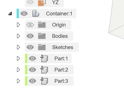

Hmm, I stand corrected although something is odd. I thought only the firs subcomponent was supposed to be grounded but now I see this happening with parts created via a rectangular pattern.
All parts are grounded !?
However, my reference structure is this one, created by API
Here the parts instantiated by the pattern are not automatically grounded (not even the first one, as I supposed it would do automatically, but I was not paying attention) and the rigid group only captures the parts that existed when the rigid group was created (:1, :2) and future changes of the parts no would lead to adding floating parts (:3).
But if the ground to parent is available via the API, it would seem I should be able to get rid of the rigid group and use the grounding instead.
