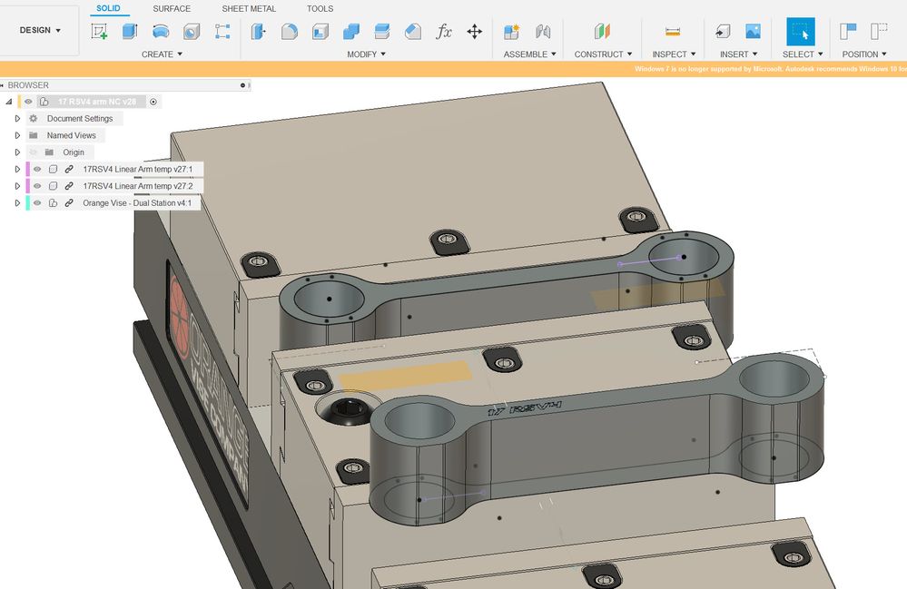

I have the same component twice, one for top machining and one for bottom machining.
I want to create a new similar part, I want to do a save as on the top assembly to rename it.  Then I want to save as and replace the components.  How can you get both components to be the same again ?  When you do save as and replace it only does one.

No this is not what I mean, because doing it this way would mean I have to redo the machining steps.
What the model is : one CNC assembly with the same component twice, one for top setup, another for bottom setup.
I am used to doing this in CATIA, I create a new CNC assembly from an existing one, with fresh names to start the design of a similar product.
Essentially I want to do a save as all, then specify the new name of the assembly, and of the component(s).
That way the machining operations would still be linked.
I know some might say there are only 3 machining operations in your second setup so just copy paste the newly saved as and replace component and redo the operations but, I have parts with 50 machining operations that I don't want to reset.
I have attached my file.
