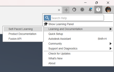

The questions you are asking have me wondering if you completed any of the free tutorial courses here.
