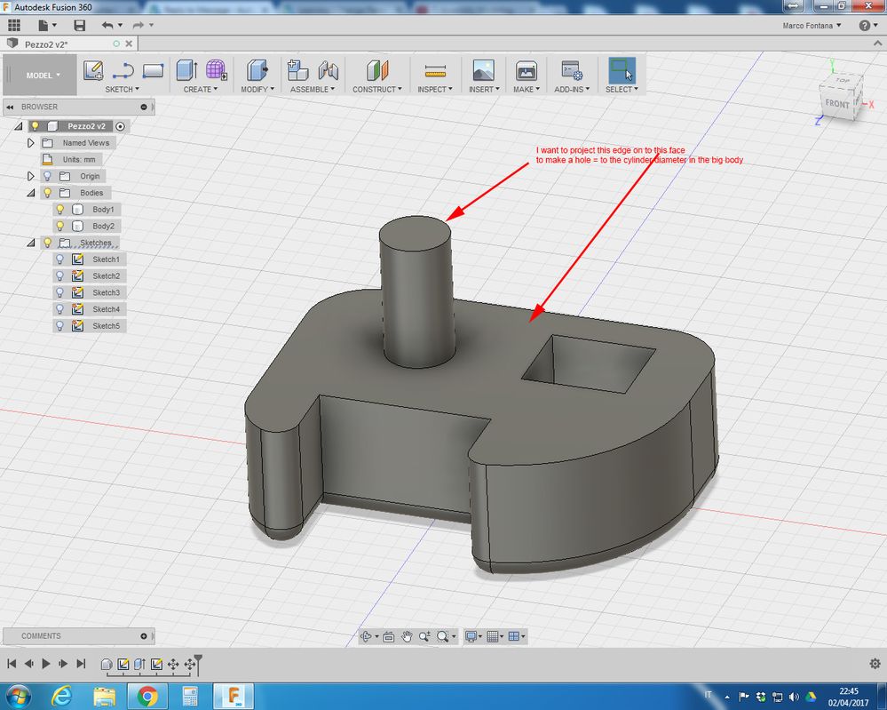

2. I'm trying to project an edge of the flat surface of a cylinder on the flat surface of a block (they are one over the other and they are two bodies) but invoking the project command, I can't select the edge...Why?

Thanks Ray, but then I've problem to understand the correct workflow.
http://a360.co/2oqVgaS
I'm not able to select the edge... Fusion 360 does not let me to select that edge!

Gooday Marco,
The Project command works inside sketches, create or edit sketches for the processes you are needing to work.
Example, you may have a sketch that the block came from, if the shaft came after that, then you need another sketch for the current operation.
Create sketch on the top face of the block, you can now project the face of the shaft into this sketch.
The next bit is to create an offset circle for the shaft hole, dimensioning the two circles with relevance to each other.
Example, shaft is 12mm, then dimension the outer circle as 0.1mm from the inner circle, if you change the shaft to 14mm, the clearance will move too,

Yes, Dave! That solved... but I don't understand... Maybe I'm twistySmiley Sad Mah.
The workflow you mentioned, is the same nearly in all cad parametric associative systems and I applied it, so the results should be correct instead of not correct. I don't know...
I did exactly as you described but yesterday it does not work... now it works, instead. Boh.

Ok, but it sounded like you may have been trying to Project / Dimension outside the sketches, in Modelling Mode.
