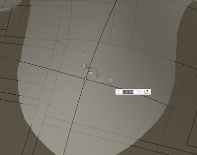

Hey guys, i have this 3d scan of a mouse and want to recreate the shape of it but modify it later on.
I managed to convert it into a body, but merging these faces leads to a change in shape.
What would be the best method to recreate the shape?
I tried using planes but was not very successful. Is there any way to snap a plane point to a face so i have the exact heigth of my 3d scan?
Thanks in advance!
539 Views
wersy
I assume that this works better with the form tool.
rehfisch.daniel
Plane is a tool from the form tools or do you mean something different?
wersy
I see, you already use form.
As far as I know, there is no way to snap anything.
