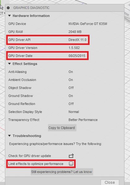

In attachment is my graphics diag.

Hi @arnou-verfaillie,
Thanks for the update.
Yes, I think it would be good idea to fix the OS but we might solve the issue you have described in another way.
I could see in your Graphics Diagnostic window that the graphics card driver may need an update.
Here are couple more things we can try to troubleshoot the issue:
  1. Could you update the graphics card driver with the link here
  2. Have you had a chance to change the GPU Driver API within the Preferences to DirectX 9.0
I hope this helps. Please, keep me updated.

I've changed the graphics to DirectX9.0 (why would 11 be an issue here?)
I've also updated my graphics driver.
I've only had 1 hang this morning, maybe because I wasn't working with a lot of components at the same time? My task manger said Fusion was using in average between 500-600 Mb of memory.

Mike.Grau
Thank you for the update.
I was assuming that DirectX 9.0 will be running more stable on your Operating System.
Yes, that is another point, keep an eye on the RAM usage which as well.
What you could try additionally is to check the Box in the "Graphics Diagnostics" window
"Limit effects to optimize performance"
I hope this could help too.

arnou-verfaillie
@Mike.Grau
Yes I have now been running without the effects limitation because, to be honest, it's pretty ugly. 😉
I'm updating this as I'm working this afternoon:
- 4 Hangs during updating less than 10s
- 1 Hang during opening a tool less than 10s (this is one is new)
- 1 Small hang during loading a component
So I think that it occurs less, and if it occurs, it doesn't take that long, so I think this might've done the trick! I will keep you posted if things change again!
