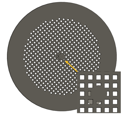

Hi, I'd like the flat outer walls to allow air to pass through easily by creating a grid / "mesh" wall.  However, fusion does not like large patterns in the sketch workspace.  I have since learned autodesk suggests making the pattern with bodies instead.  However, this still seems to be too much for fusion to handle.  I absolutely refuse to believe this is an abnormal use case.  What is the proper way to model a "meshed" surface?
Link to my exact issue  - I have tried the pattern in bodies solution
I have attached a save of the project and a screenshot of the product.

Pattern in Manufacturing instead of Design.  If you want to see it in the Design workspace, use a decal.
ETFrench
Message 3 of 20
etfrench
You only need one Grid Tool located at the Origin.  Cut one hole, then pattern the (hole) feature.

doncawley
I've yet to use the manufacture workspace and I didn't even see create pattern...so im lost on that option.  Patterning the hole sounds like a great option though.
I powered through the insane pain at got the cutouts working with the 589 bodies, but will keep patterning holes for future reference!

definitely do not use sketch pattern for even medium-sized patterns.  When patterning in the solid world, if you can use face pattern or "optimized" feature pattern, you will get much better performance.  This size of pattern should be fairly fast.  If you get to the point of a thousand holes or more, then you will have to expect some performance challenges, even with optimized patterns.

In this method, the pattern is created only for fully covered elements with a reference body.
(view in My Videos)
Note: The calculation time is longer because of the necessary adjustment to the reference body.

When you create feature patterns, make sure to pay attention to the options in the Pattern dialogue.
Particularly for large patterns, changing from the default "Adjust" to "Identical"  or "Optimized" can make a significant and positive performance difference:
