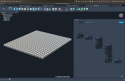

This first test was built in Python, HTML, JavaScript, CSS, and React using ReactFlow as the framework for the Node interface. I can dive deeper into how it works, but it essentially takes advantage of the lightweight Direct Modeling tools built into Fusion. Since the result is driven by the node graph, I can skip the complex parametric overhead. This allows me to build a lot of boxes near instantly:

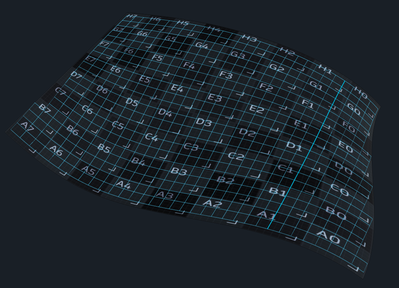

The next logical step was to try to pattern the boxes along a surface. I developed this test surface that has some very specific surface topology - things like convex to concave, and varying compression and expansion of the surface isoparametric features.
My surface patterning tools allow me to conform explicitly to the flow of the surface UV topology, or defy it to create regular grids on non-regular surfaces like below:
