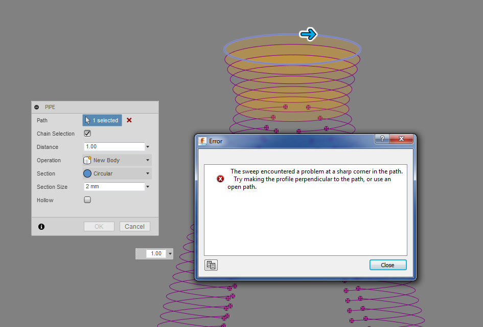

problem with pipe on closed circle

Pipe is failing on the projected loops from your bottle body which started as a Sculpt body. To be clear: pipe can work on closed circles, just not ones projected from sculpt bodies like these are.
The issue is now logged as FUS-18897. Thanks for reporting it!

cekuhnen
you are welcome - bug hunter at work 😉

Phil.E
Just tested the fix. Looks good. It should be out in September. Thanks again for reporting it!
