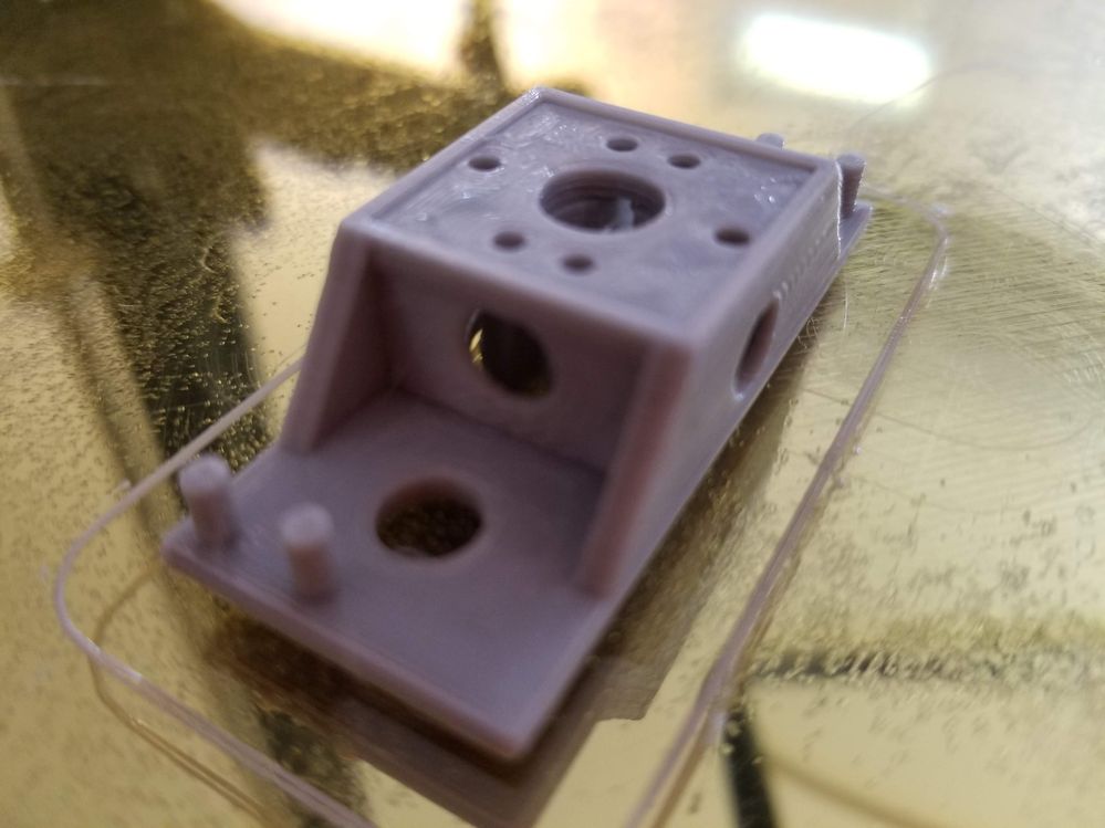

I have been having an issue with Fusion 360 and 3D Printing my designs. I am certain that the issue I'm about to discuss is of my own making but I need some assistance in discovering what I'm doing or thinking that's causing my problem. If I have posted this in the wrong location, please forgive me and move it to wherever it is the most appropriate.
I don't know how to state my problem succinctly but it has to do with extrusions and the way they turn out on my 3D printer. I also don't know if it happens all the time with every extrusion or with just some extrusions, but when it does occur, the parts that get 3D printed are very weak along the boundaries of the extrusion. I have had this problem a number of times and I'm confused as to what is happening to cause the problem.

Fusion 360 Part for examination: Deflector Plate
For my second example, this is a part I have been working on for a while and have gone through several iterations of it with each getting successively weaker in the areas between the extrusions. Which is pretty much the same problem I had with the box model in the previous example. The most recent version I printed out was so fragile it broke apart very shortly after I pulled it off of the 3D printer, just by handling it.
As you can see in the pictures below, rather than being solid models, they just fall apart at the extrusions.
In my sketches, all I'm doing is creating the various circles and whatnot and then highlighting what I need to extrude and entering the thickness. When I look at the part in Fusion 360 I don't see any problems with it. It is only when I download it and slice it up (and I've used several different slicers) and then print it out that I have problems.
I have other examples of other models that I've made that have this problem. When I examine the part it always comes back to problems around the extrusions. I do not have this problem with other parts that I download and print. Only the things that I design myself.
Can anybody help me understand what I'm doing wrong??

Here are some pictures which illustrate the problem:
Example of Finished PartExample of Finished PartAnother Example of Finished PartAnother Example of Finished PartHow 3D Printer is Creating PartHow 3D Printer is Creating PartAn Iteration Showing Extrusion ProblemAn Iteration Showing Extrusion ProblemAnother View of Extrusion ProblemAnother View of Extrusion ProblemA Different IterationA Different IterationDifferent Iteration With Extrusion ProblemDifferent Iteration With Extrusion ProblemDifferent  Iteration Another View of Extrusion ProblemDifferent Iteration Another View of Extrusion ProblemExtrusions Seen in Simplify3DExtrusions Seen in Simplify3DBottom Layers in Simplify3DBottom Layers in Simplify3D
