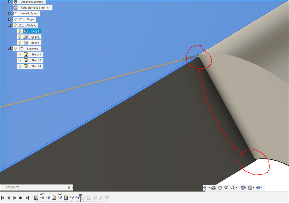

OK, see the updated file attached. This is the part I am trying to make but I would like to be able to flatten it out completely. You can see in the picture below that when I turn it into a flat pattern it does not flatten completely (the arrows are pointing to the remaining curves).

Well a bit closer, Your sketches are not accurate enough (or fully defined,) for Fusion,
The faces of body 1 is not colinear with Body3, there is a step.
and I don't know sheet metal well enough to fix it, but
Your body 1 and 3 should be a one piece extrusion 1 inch high, (Will Flat Pattern as per previous pic)
with the bolt plate and the end curve flanges added to that single body (joined)
To Flat Pattern, build one body, by adding the Flanges to it,  just like you did for Body 1
You have combine joined body 1 with 3, 4, and due to the sketch misalignment, will not Flat Pattern.

You can't flange off of a bend. You'll need at least a tiny straight bit at the end of that large radius bend in order to flange off of. That's why, in the above Screencast, I add a .01-inch straight line to your sketch include it in the first flange upwards.

antswanmail
Thanks everyone for your help, I got it to work.
