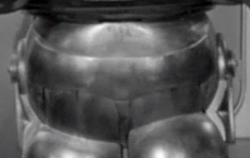

Hi
I am reworking an old project but struggling to recreate this complex shape. I four different profiles to join and a loft didn't work as per my normal attempts so I used a patch, but I cannot thicken the result 6mm that I need.  Here is where I am at:
Here is the error when I try to thicken it:
Any help to move forward on this would be great as I have been stuck on this for weeks. Restarting the project over and over and arriving at the same problem.

Its been the problem that I have created the rest and then returned to that area and tried to thicken it and it hasn't worked which is why I was going to see about sorting it now. It actually needs to be mirrored. The whole shape would be good to do in one big loft but I haven't been able to achieve that. The circle at the top seems to make it a very difficult thing to do.
This is the shape  I am trying to create:
Screenshot 2020-10-18 211113.jpgScreenshot 2020-10-18 211037.jpgScreenshot 2020-10-18 210916.jpg
Would you know why I could only make that panel in a patch and not a loft. A loft is what I am use to.
But if you have time to help me get that part working it probably will help me with the rest.

Loft the half front view to the half side view, and horizontal rails, then shell 6mm.
Might help....

I can see what you mean about the holes on the side. They are for leg hinge pivots so they need to be round.
Is it hard to do define what else I need to get them to be round?
Regards

Thanks for the second option. Unfortunately I don't make it easy for myself, because the original design of the prop requires the top circle to be correct and those side circles to be correct. I realize you said we carn't have both, but I need both to be circles.
I tried this, I added circle extruded sides in but, the ridges will be problems:
So are you sure there is no way to get both top and side circles correct with the loft?
Regards
Ian
