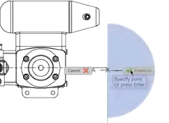

When I right-click after placing the second point for a section view I am not getting the "Continue" option (top image).  Instead, I get an expanded menu and a greyed out "OK" option (bottom image).  I'm using a Mac.
Can anyone tell me what's going on?
Screen Shot 2018-11-19 at 12.31.27 PM.pngScreen Shot 2018-11-16 at 4.26.54 PM.png

Hi garmitage,
This sounds like a bug we had identified with the right-click menu options during some commands.  I will check in our system for this.  Instead of right-click > OK if you hit Enter instead you should be able to proceed and place the section view.

garmitage
Unfortunately, pressing enter before or after the right click has not
useful effect.

Hi garmitage,
Just confirming that in your lower image you have indeed actually clicked to place the second section line point?  If you move your cursor away from the endpoint are you dragging out a new section line segment?  My reason for checking is we've had a similar report before, here.

garmitage
As soon as I click the second point I get the new section line, and whether I right click before of after I get the same thing.  The right click after the second point is working now.  I thought that's what I tried after your suggestion, but maybe not.  Hopefully this glitch will get fixed.
