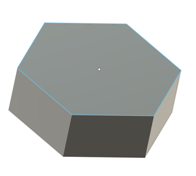

I'm trying to create a threaded nut where the thread type is NPT. If I try to use the Thread tool, it does not have NPT as a selection option. I came across a YouTube video where it shows how to create an NPT thread using the HOLE tool. But that's not working either. Here's what I did:
I created a nut-shaped body.

NPT internal threads are not included in Fusion 360.  The easiest method to mode them is to download a threaded nipple, with the desired NPT thread and use the Combine command to create the NPT tapped hole you need.  Model is attached.  If you cannot figure out the timeline, let me know.

That's known as a 'cosmetic thread' and is a common method of giving a thread-like look without the computational overhead of actually modelling it. This is usually sufficient in real-world manufacturing as the hole and/or thread is usually specified on the drawing that you give the manufacturer and doesn't require it to be modelled. If you're going to 3D print your part however you'll want it actually modelled. Unfortunately as @jhackney1972 alluded to, modelled tapered threads have not been implemented as yet in F360.
Again, as @jhackney1972 mentioned you could use something with an external NPT thread and use it as a 'tool' to form the hole in your nut. Alternatively, if you don't need it to seal you can use an NPS or NPSM* thread in your hole. These will mate with an NPT but won't seal on the thread. Unfortunately F360 doesn't come with NPS or NPSM thread files. If you search the forum I think you'll find one has been posted before. If not I have one you can have but off the top of my head I'm not sure how complete it is.

I did indeed download the file you provided. I had to slightly modify the body of the bolt, shrinking it by about 7.5%  in the X and Y dimensions (keeping the length dimension) in order to compensate for the precision (or, lack thereof) of my 3D printer. I also created a nut version (threads on the inside) from your file and increased the size by about 7.5%, again in the X and Y dimensions. I now have a bolt and a nut that fits pretty well with each other and on the actual shower head objects.
