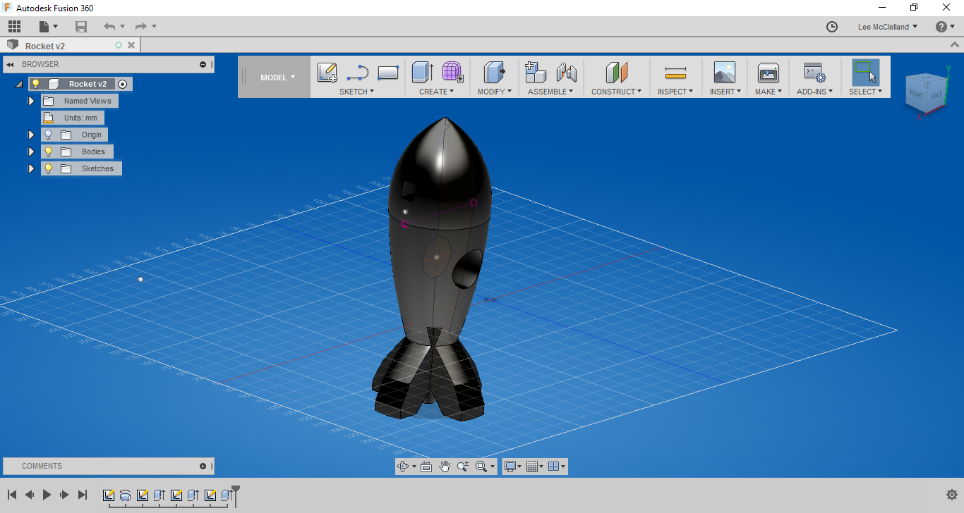

I've need to create a layered card model.
I've created the body, split bodies at every 1.5mm (card thickness) and now I need to print each split body to use as a template to cut the card. The only option I'm given is 3D printing. Is there no way to print out onto a normal printer so I can create the card model?
