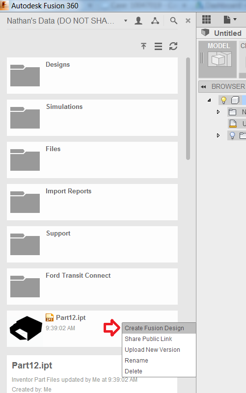

This doesn't sound like the correct behavior, but I note that I am getting a similar issue. When I upload CAD data to the previews for some file formats appear to be pretty dark.
I note that if you find those IGES file in your data panel in Fusion 360, right click on them and select Create Fusion Design, the previews are much brighter since the file is converted to a native Fusion 360 file.
This may be used as a work around solution in the interim. I will report this to development. Thank you for reporting this!
