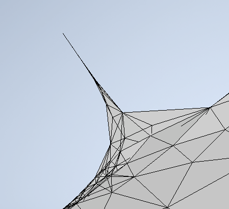

Is the file that you attached the original stl, or is it one that you have already edited?
I see several areas that I would fix in MeshMixer first.  The overall quality appears to be very poor.
