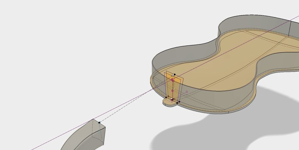

I just ran into this interesting behavior with creating a plane through three points:
First I tried creating a plane through three points. Whoops! error! Whaaa?
Edit frature. Two points missing. Huh. OK. Reselect points:
Looks fine, save it:
Wait, what?
Oh, right off the end of some completely different line that has nothing to do with the points I clicked on. I get it now...
Anyone else experience this?

@SEIZMICdesign,
Are you able to share the model so that I can look into what is happening?  You can email me the archive file directly at mike.prom@autodesk.com

@SEIZMICdesign,
Thank you for sharing your model with me.  I was able to edit the plane that you were having an issue with and select the missing point.  As far as making points tangent to the lines, points in theory are not able to be tangent to a line.  However you can make points coincident to a line, the best workflow it to project and then constrain.
Here is a link of repairing the plane.  I reset the points, that step wasn't needed, I just wanted to show another way to approach a solution.
http://autode.sk/2c0QskK
Cheers,
Mike Prom

SEIZMICdesign
I had tried basically the same thing only using the Construct -> Point At Edge And Plane method. For whatever reason, that was the incorrect method. Now I know!
