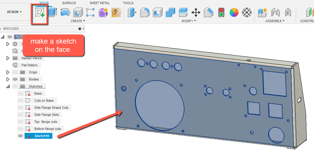

In my opinion you would benefit from working it the other way around. Much like how CNC programming is made by using data from the design, making a precision silk screen is also a manufacturing process that is done using data from the design. In this case, sketch data is perfect for generating a silk screen.
Steps:
  • When you have a panel ready for silk screen, make a sketch on that face. Add nothing to it.
  • Find it in the browser, then right click on it and use "save as dxf"
  • Open the DXF in Corel
  • Add silk screen art in the dxf.
Benefits of this method:
  • A dxf file is a perfect rendition of the panel geometry, highly accurate.
  • The dxf is created by the existing geometry. It's always up to date, and most importantly for you, it's already done. No double design work is needed.
  • Avoiding cumbersome work using a command that is not intended for the job. Decal is not built do validate silk screen art. This is a little like using screenshots and video to validate tool paths. Images are never as accurate as CAD geometry.

It had never occurred to me that I could import a dxf file into CorelDraw.  I just tried it and it works perfectly.  This was a great idea!  Thanks for suggesting it.
