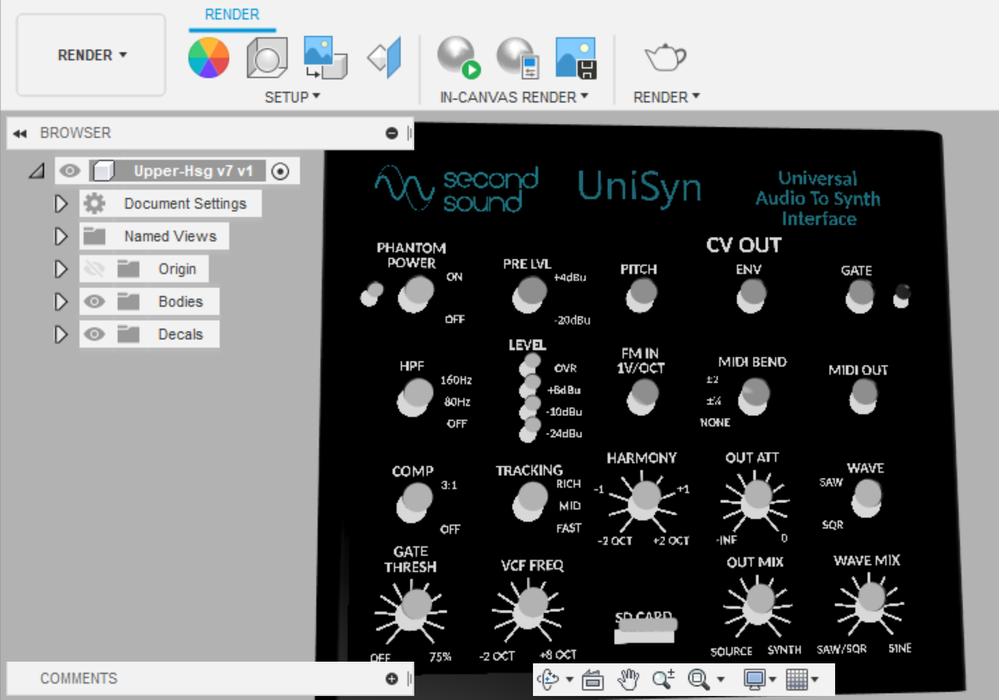

Hello, I know this is an old thread but I just found it due to the same decal scaling problems I just started having this week.  Even if we give up on Fusion 360 recognizing some kind of absolute size scale on imported decals, there are still some major problems with the way the decal scaling and shifting UI works.
1) First of all, the scale isn't "persistent" meaning if I scale a decal by 2.0 and find out it's still not big enough, I need to scale it by something like 1.01 or even 1.005 the next time.  So the decal scaling multiplier is cumulative???  Why on Earth would you make it like that, it's just crazy, Man!
2) The shifting utility has hysteresis that makes it impossible sometimes to place the decal exactly where you want it!  What do I mean by this?  Let's say I have to shift my decal by 2mm in the x-direction.  I type 1mm, 2mm, 3mm into the UI and nothing happens!  The decal stays right where it is.  Then when I finally reach 10mm, it makes a huge jump by 10mm and overshoots the target!  Then when I go backwards from 10mm, the same thing happens, 10mm, 9mm, 8mm, etc.. NOTHING!  Then when I get back to 0mm, it jumps back to the original spot.
I would be very willing to give up some kind of "absolute image scaling" which would presumably be able to get the decal at the right size from the start in favor of a scaling and shifting UI that doesn't function like a possessed demon.
Message 32 of 118
in reply to: Phil.E
Let me give some more details on my issue.  I'm trying to place a decal on a surface with lots of holes on it.  I un-check "Chain Faces" so the decal geometry will ignore the holes.  I have white circles in the decal which are supposed to line up exactly with the holes so I can place it accurately.  Here is what I'm talking about:
Decal is either too far in one direction:
Or too far in the other direction:
decal_too_high.pngWhenever I try to move the decal so the white circles overlap the holes, it jumps over the holes for some reason.  Is there a way to fix this?
Message 33 of 118
in reply to: Anonymous
OK, I finally solved this problem.  The problem is that the CENTER of the decal cannot be placed over a hole.  I extended the decal down in the y-direction and cropped it on the other side in the y-direction so that the center wouldn't land on a hole.

import that image as a png to the face of the object in Fusion.
then scale the png decal up to fit.
You can view example here.
https://antonkimball.com/2019/07/stiletto/
or here
http://www.markjohnsons.com/?portfolio=veive
or here
https://antonkimball.com/2020/07/potion-2/
or here for package design, the artwork, DECAL actually has the hang tag HOLE draw in, because as you know, in Fusion, decals get fussy around holes in objects sometimes.
https://antonkimball.com/2020/07/chewybigdeliciousgummys/
hope this helps.
