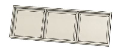

I am having a problem trying to create a configurable tray with a variable number of slots of varying widths. I am hoping that someone can suggest a better way, or at least one that works.

A different method - Tray with variable slots and bug
Instead of using rectangles for the dividers, I switched to parallel lines, which does allow a distance of zero between them. (I am using slot widths of 10 + slot number to make it easier to see what is happening when I make changes.)
This is the tray using all slots.
Now I can just change the slot sizes to create a tray with 3 slots and make slot 2 wider.
This works fine. There are no errors showing in the timeline and the body is exactly how I specified it. It appears that this design will work.

Have you tried configuration feature to create the above tray, i feel it is good example to create using configuration feature.
Also using zero dimension may cause trouble in solving so we recommend not to use them but please feel free to contact me on my email id (sameer.babar@autodesk.com) , we would like to hear more about this workflow and may be provide better solution.

I found that 0 dimension was a problem and I am now just moving all of the unneeded partitions into the wall where they become part of the wall.
I cannot use configurations because the API does not yet support write access and I use the API to generate variations of the tray as needed.
