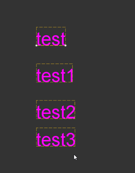

HughesTooling
@es412 wrote:
 The work around using extruded bodies is not Ideal because I would like to be able to edit the text once it is repeated.  I am currently trying to produce test samples with incremental adjustments and the text will serve as a label.  So two features would be great to have here:
If you want to edit the text in the copies a pattern is not really the best idea because patterned copies will not be editable without breaking\deleting the pattern. Your best bet is the create the first text label then use copy paste, this way the copies will be editable.
This example is made by copying the test text once then paste 3 time and edit.
Mark
