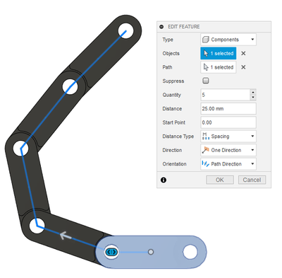

Hey,
I´ve included a screencast with spoken explanation where I describe my problem. It´s best you watch this, easier than writing it all.
https://screencast.autodesk.com/Embed/Timeline/8b04edcb-14ed-496b-9d2d-8ff4adc0c684
Shortform in text:
I need to create a pattern of a component along a curved line from a sketch. Problem is that the components do not follow the path perfectly. From what I can figure this is due to the "origin" of the compenent being vertically offset and not in line with the path. I suspect this is because the compenent is not perfectly symmetric along this axis.
To test this I have recreated the component in its most basic dimension but made it symmetrical, the "origin" of this compenent is now in line with the path. If I use this component to create the pattern everything lines up perfectly.
The question is how do I fix this, can I move the "origin" of the component somehow?
For clarification the actual origin of the part (the one that you can choose via the the list of the components on the left) actually is in line  with the path. Only the "origin" that is displayed when I choose to move the component is offset.
Thanks for your help

johan.rutgeerts
I faced the same problem. I consider this a bug.
I found following (limited) workaround. Mind you, it's ugly!
Consider a certain path:
Project it in a new sketch and manually draw a segment for each chain link. You need to two lines for each segment. E.g. if your pitch is 25mm (red arrow), then draw two parallel lines of 12,5mm each (green arrows). For the first chain link, only draw the 'second halve' of the segment (blue arrow):
Position your first chain link centered on the start of this newly sketched path:
Create the pattern, start point = 0, distance = the chain pitch:
There you go.
I told you it wasn't pretty. 😉
Above example file in attachment.

johan.rutgeerts
@davebYYPCU wrote:
I don't think it is a bug just a limitation of the Pattern on Path.
Imo it's an unfinished implementation, that someone deemed "good enough to be released", as it is to some extent functional (e.g. if your pitch is small enough wrt the curvature, the position error becomes neglectable). Unfortunately, it is also buggy.
Consider this:
Set 0.5 as start point, the pattern disappears:
Revert start point to zero, the pattern appears inverted !?
While making these screenshots, I noticed that the reason is that the trajectory is flipped when the start point becomes larger than the pitch (??). So when reverting to zero, the start point is at the other side of the trajectory (compare to the initial screenshot):
Call it a bug, call it a limitation, unexpected behavior, whatever. In any case if I were responsible for this implementation, I would not be proud of it. Even the documentation seems unfinished: I did not find any official documentation as to the exact function of the parameter 'Start point'.

johan.rutgeerts
@davebYYPCU wrote:
Yes, Start point other than zero, usually pushes the parts off any curved path.
Ok but that's a bug. It is not normal behavior. Or at the very least the way it works should be clearly documented.
The limitation here is attempting to align the holes in the part to the path, whereas the function will likely be to align an arbitrary point within the object being patterned.  Start point may well be that parameter for the object's offset.
The way it aligns is as follows:
From the start point of the trajectory (at least when parameter 'start point' is set to zero): locate the point along the path at a distance as set by parameter 'Distance'. E.g. in this case, Distance is 25mm, which equals to 17,50 mm linear + 7,5mm arc length:
At that point, place the next instance, oriented according to the tangent of the path at that point.
This is relative to the pose of the initial component wrt the trajectory, e.g. compare with this (first link moved 12,5mm to the right):
Or this (first link moved 12,5mm to the right and rotated 90deg CCW):
For the record:  this is not buggy behavior. It is limited, in that you cannot adequately model chains with large pitch wrt the curve radius. But it has its relevance.
