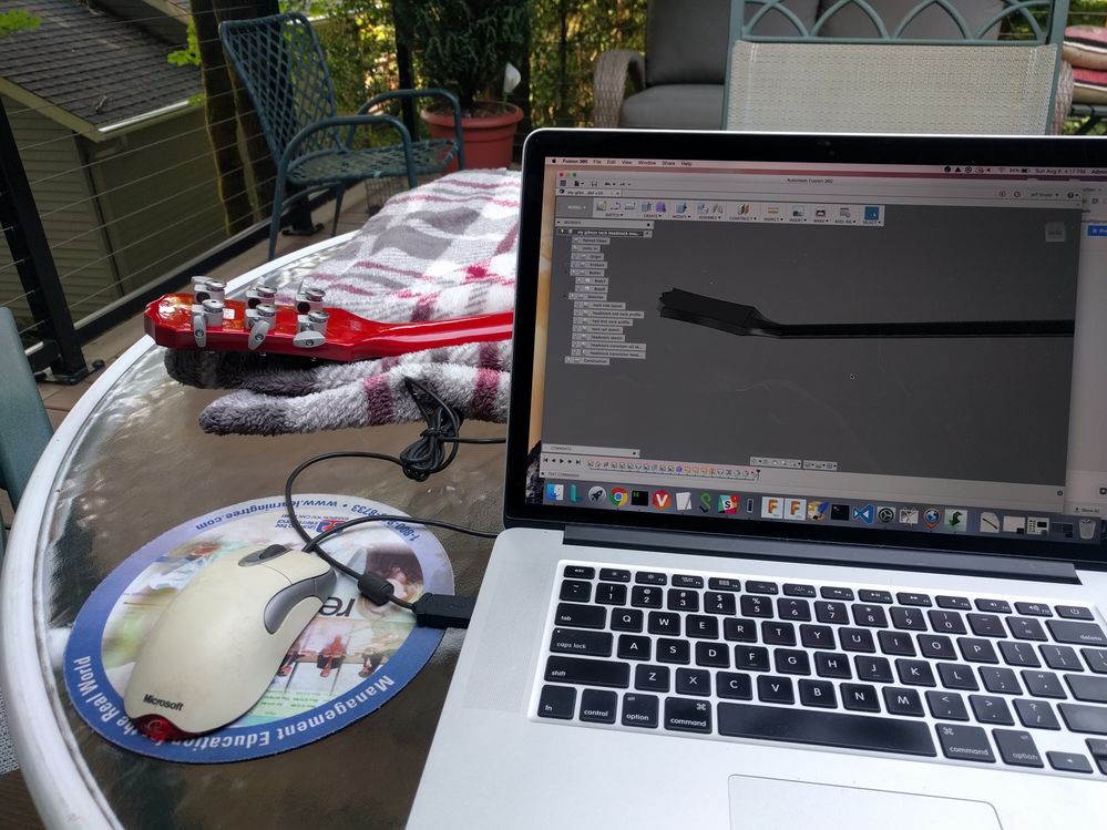

jeff_strater
BTW, this is how I spent part of my afternoon - on the deck, in Fusion, with my Epiphone Les Paul upside down in front of me:
Jeff Strater
Engineering Director
Message 39 of 134
