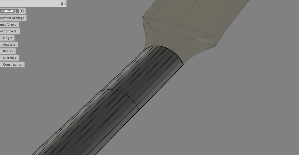

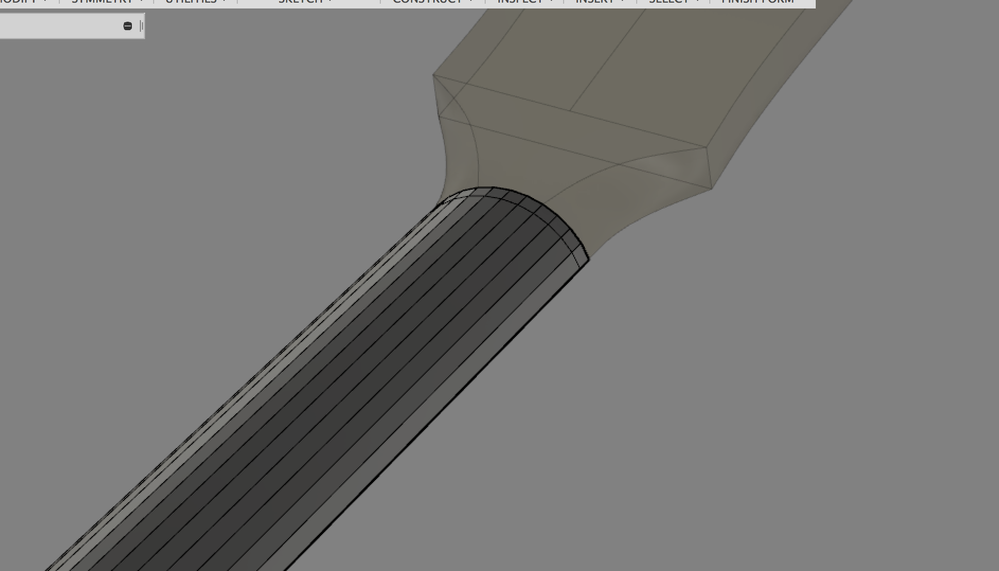

Hello Guys, I seem to be running into an issue when I try to insert a t-spline edge into my neck in order to create a loop cut. The problem is that I'm unable to place the t-spline edge where I want it to be. I'm trying to insert the t-spline edge close to the neck end where it joins the head stock. For whatever reason, the t-spline seems to insert itself much farther away than I want, not matter how close I move it to the end of the neck/headstock transition. Am I doing something incorrectly or is this a problem with the program? I've attached my file.

Hi @oldtbone55,
I think that this is just the nature of the TSpline smoothing algorithm.  If you look at it in Box mode, you can see that the edge was inserted where you specified.
However, when the TSpline smooth faces are calculated, you can see that the apparent edge is inserted farther away.
I am not familiar with the math behind TSplines, but I suspect that it is because these faces are so long and narrow.  Short of adding more edges along the length of your neck, I'm not quite sure how to get what I think you want.  Others might have better ideas.

"I'm trying to insert the t-spline edge close to the neck end where it joins the head stock. For whatever reason, the t-spline seems to insert itself much farther away than I want, not matter how close I move it to the end of the neck/headstock transition. Am I doing something incorrectly or is this a problem with the program?"
No you are not doing anything wrong, the reason this is happening is because of surface tension. The only way to stop this is to add a bunch of edge loops all the way down the neck. This is why if you look at the initial T-Spline model I showed you how to make I had a bunch of them down the neck. Surface tension is the reason most people have trouble with T-Splines because they don't understand it.
T-Spline by nature are G2 curvature across the spans (unless you crease an edge) so when you place an edge loop the T-Spline math has to achieve this and the only way to do it is to move the edge loop into the required location. Remember that you are modifying the control cage which works a lot like CV curves. What you are expecting to happen is for it to act like through point curves, but it doesn't work that way. There is no way to gauge how to land a edge loop exactly where you want it with the current tools. This is why I use Topogun because it allows me to do what Fusion can't, but that is a whole other story because retopo also has a steep learning curve.

Box mode is your T-Spline quality control. If things look smooth in box mode then they'll be fine in smooth mode, but as you've now observed not necessarily the other way around.
That's also why you start with not too much geometry and the shape as close as you can. Then when you come across situations like this where you can see that in box mode you have to stretch things too much too far, you'l add edge loops (geometry) to give you a bit more control over the geometry. With that approach you mostly have to fine-tune and edit smaller changes in localized areas and not have to deal with editing all of the now increased numbers of vertices.
If you do need to edit a higher number of vertices, try to experiment with "soft modification". But remember, T-Slines want to e treated gently 😉
