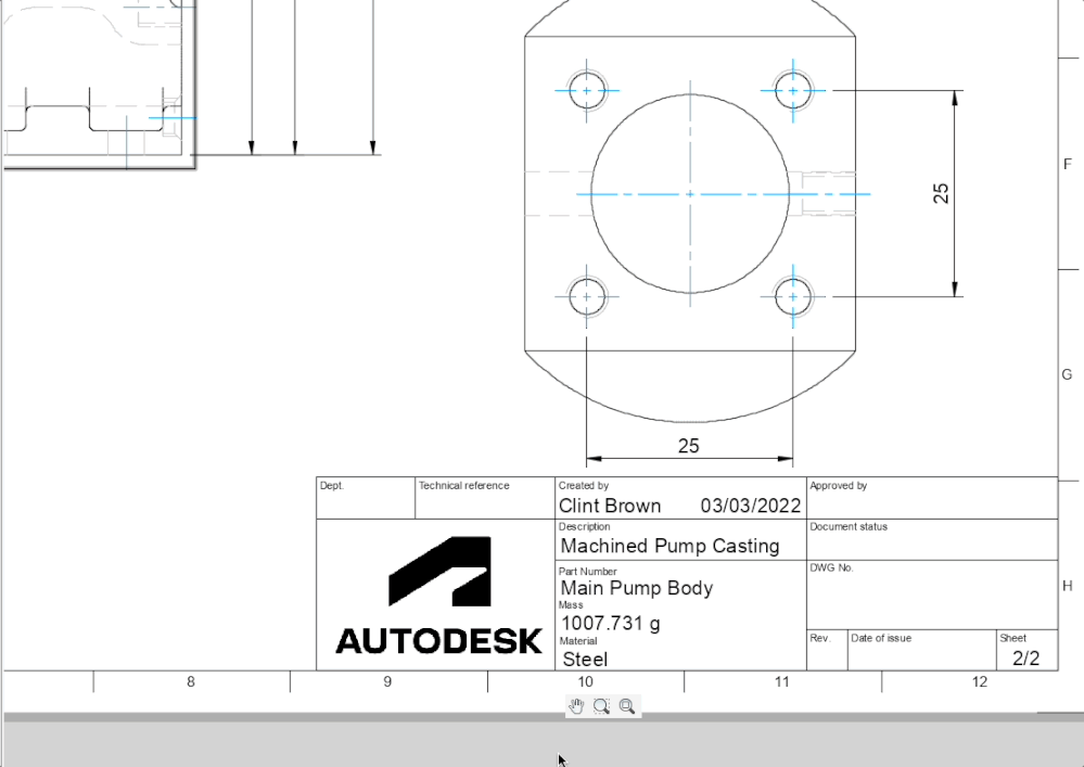

Thanks for sharing. Some of what you have mentioned is in our longer-term planning. As always every customer request that we get, from meetings, emails, forum posts etc. gets collected and categorised in our feature request database. This information is used to prioritise the features that we build. I've added your requests to our database.
In the November release, we added "Duplicate Sheet" functionality, this will help with your workflow of creating another sheet, and making subtle changes. Here's a GIF of the new tool in action, link in the what's new post below.
https://www.autodesk.com/products/fusion-360/blog/november-2022-major-product-update/#Drawings
