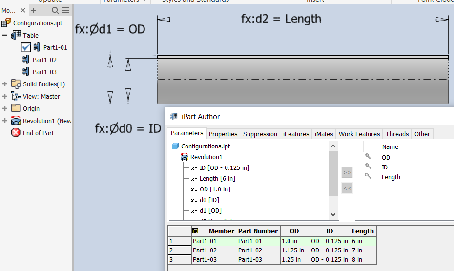

TheCADWhisperer
@g-andresen wrote:
Can you explain your ideas with a parameter list and the screenshot(s) as an example?
I think that the OP is looking for something similar to this.

SithechCustoms
Yes, I think you're on the right track.  Select the different part number, and the different parameters are automatically updated and the solid model is then updated according to which set of parameters you selected.  Still all the while only having a single component in the Fusion file.

TheCADWhisperer
@SithechCustoms wrote:
... SolidWorks has the function that I'm talking about.  .....
Autodesk Inventor is the Autodesk product equivalent of SolidWorks.
