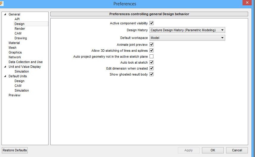

Here's my settings, I'm using a PC.
I also have Auto Look at sketch enabled,
