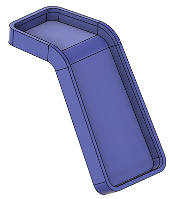

I’ve manually drawn every line and arc—no imported geometry, no projection to surface.
Sketch is fully constrained, closed, and dimensioned.
Fusion 360 throws “Could not offset curves” error.
I’ve rebuilt the sketch, stripped constraints, tried clean planes—same result.
This is not user error. It’s a sketch engine failure.
How do I force Fusion to offset this geometry, or is this a known bug?
Screenshots attached. I’m looking for a real fix, not generic advice.

Yes, the original design was using the surface workspace, with a thickness of 12mm. I split the body so the top half is 3mm and the bottom 9mm, I'm trying to create a lip on the bottom face so it will friction fit inside the bottom half, yet to be shelled to 3mm. Offsetting the perimeter to 3.1mm and dimensioned downward 3mm, using the sweep command to match the geometry. What I've done so far is used an offset plane on the bottom and projected to surface the edges and curves. I assume Fusion locks the geometry and construction, so I drew the edges and curves manually. When I try to offset the edges and curves I drew, they are not being selected for offset. It is indeed a 3d sketch.

Before I go to the next step, did you really want these two sides to be curved or did you want them to be straight planar faces?
(Loft returns curves that are not really defined without additional geometry.)
Also, what appears to be a circular/cylindrical portion arc is not a circular/cylindrical portion arc face.
What appear to be planar faces are not planar faces (you can test this by attempting to start a new sketch on the "planar" faces).
Thicken of the surface introduces further ambiguity on the side faces.
Click on image above to enlarge the view to observe the thickened sides.

This isn't answering my question. How do I project the geometry from the body so I can offset the edges -3.1mm. As for the geometries not being real world, I can sure you I have tools that actually measure the geometries in the real world. Using the loft command makes a solid body.
Sometimes the answers are much more difficult than they seem.
@TheCADWhisperer didn't point out the geometric errors to you out of spite, but because workflow errors made in early stages accumulate and make it difficult, if not impossible, to create correct solutions in later stages.
If you're asking about offsetting a 3D sketch, such a command doesn't exist.
This follows from simple logic: a 2D sketch can be offset on the plane it's on.
"Offsetting" a 3D sketch is a mathematically infinite set of potential scenarios.
Therefore, there's no such function—because there's no objective logic that could predict your goal.
If you want to obtain a set of curves or edges offset in a specific direction (or according to a specific rule), you must explicitly define that rule (direction) in the workflow.
This is accomplished using commands from the surface modeling area, among others.
If you want precise guidance on your workflow, sketch out the desired outcome on paper so we know where you are going and can suggest optimal solutions.

Hi! I believe you are looking for Ruled Surface. Use Ruled Surface command and select the edges so that the surface will protrude in the normal direction at a given distance. Then the inner loop is the offset edges you are looking for.
