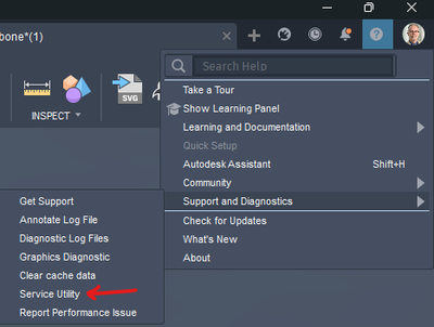

TrippyLighting
I would try to use the service utility to repair the Fusion installation. I see the meu option on my computer:
Depending on what you want to do with the mesh, converting it isn't a good idea!

you have the convert mesh option on your computer? I've tried repairing it and trying again but no luck. I'll try another computer.

Maybe the conversion broke your install! Perhaps a restart and try again or as TrippyLighting suggests run the Repair Utility.
