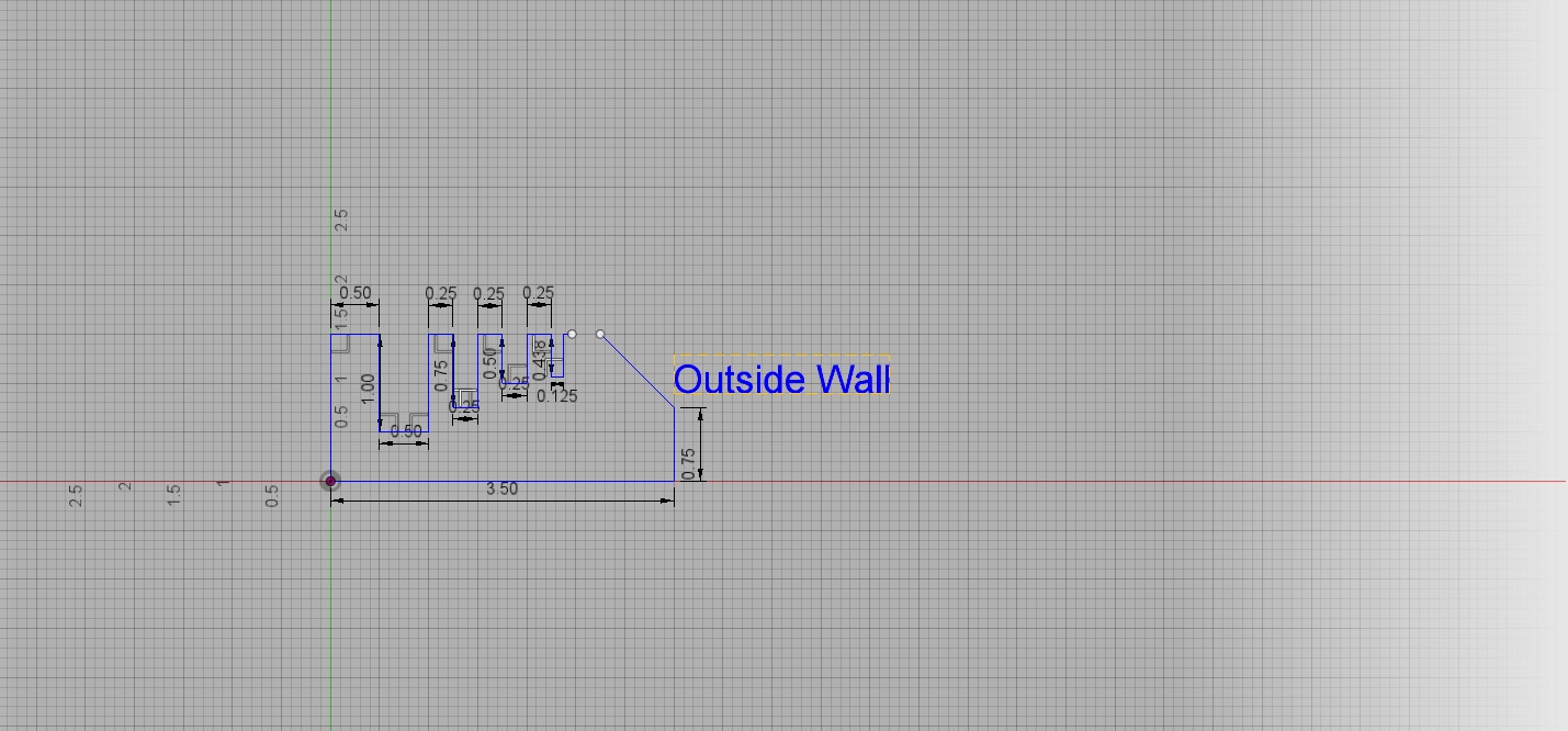

So I'm learning how to sketch out my drawings, and have been making good use of the Sketch Dimensions command, but I was wondering if there is a way to add additional text comments to my dimension or as a sepearate text label?
Ideally I would be able to enter a dimension value like 50mm followed by the ability to add some custom text ex: "50mm outside wall"
Is there an easy way to add custom text labels to a model? I tried inserting a SVG but got a weird bad lexical error message. I found Model > Sketch > Text, but I believe that text becomes part of the model instead of just a label. True?
thanks,
Stephen

Hey @Anonymous, thank you for reaching out. What are you trying to achieve with the drawing you are creating? It is to turn it into 3D geometry? Or is it purely to document and communicate the design as a 2D drawing?
I ask because the ketching environment is really built to create 3D geometry based on the sketches you make whereas our 2D drawings environment is for documenting the design. There is currently no direct way to annotate in the sketching environment, but 2D drawings does have that functionality.

Hi Keqing,
Thanks. I had no idea you had a New > New Drawing > From Design
I like that is has a full blown commenting section.
I use 2D sketches to create full blown 3D models and output to a 3D Printrbot and I'm now trying to output to a Shopbot.
I was hoping to add labels and comments to the model for my own notes (things like feature names on the model, hold down placements and which end mills to use).
Hopefully you'll look at adding commenting to 3D models, but your tip on 2D drawings from design is very helpful.
