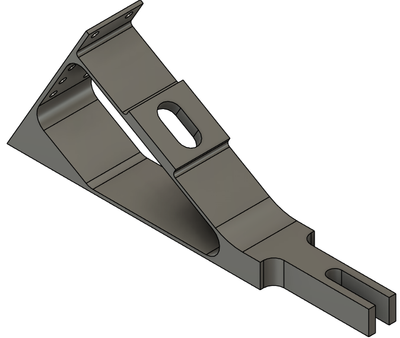

Hello everyone, I'm Niesha. I recently enrolled in a cnc manufacturing class that has us using fusion 360 and I'm still learning my way around the software. I'm looking to connect with as many peoples as I can to master the program. I am eager to learn from everyone in hopes to land a job in manufacturing. Since I started my class in June our teacher has given us a bunch of scale drawings and this one, I'm working on now is pretty tough. I have attached pics of the drawings if someone could help me understand how to create the back piece it looks like it bends up but I'm not sure how to get the proper measurements with that piece going up. Do I create a rectangle or draw lines to make that piece? Any help is appreciated. Thank you in Advance.

Sorry I think it shows a bit clearer here you know the two fork pieces in the front. I drew my measurements on the side but they didn't connect with the forks.

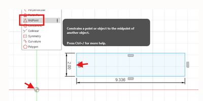

This next step is critical - always use symmetry about the Origin when practical.
Add a Midpoint Constraint between the Origin and the midpoint of the left vertical line of the Rectangle.
Click on image above to enlarge the view.
