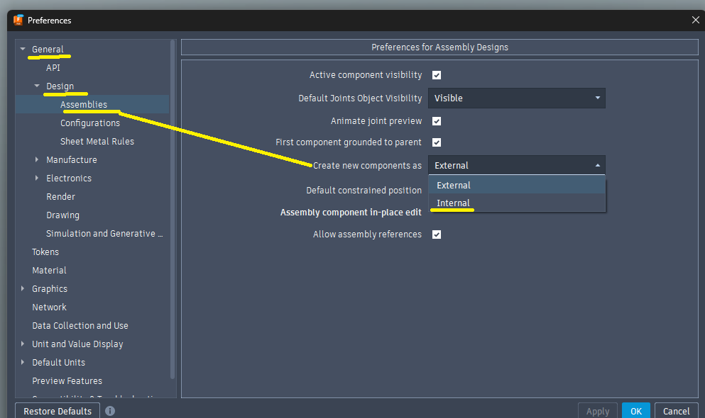

Phil.E
Change your preferences:
preference for new file typepreference for new file type

Message 10 of 41
crueby1
Phil, my setting IS to 'internal' already!  And, as I said, I am not using assemblies, just hybrid projects. That default does not change anything for what I see when I pick a new component from a hybrid project. If it is supposed to, then it is a bug and going to a external component.
Message 11 of 41
bwalker145
Hi @Phil.E , preferences is already set to that and it has no impact.

I see it now. No matter what your settings, all new components are external when your default New Component = Hybrid Type. A hybrid external component is created. Expected result is a hybrid internal component is created. This is possible by using Parts.
  • Set preferences to Default Design Type = Part
  • Set assembly preference to Create New Components as = Internal
And yes, I see that when creating a new design entirely, you now have to click Hybrid.

g-andresen
I don't understand your explanation.
If “Internal” is selected in the settings, I assume that this setting is also applied in the menu for creating a new component.
However, an external storage location is already preset.
An internal component can only be created by selecting the “Part” type or by deselecting it and then removing the link.
