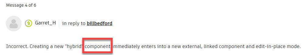

Garret_H
Incorrect. Creating a new "hybrid" component immediately enters into a new external, linked component and edit-in-place mode.
