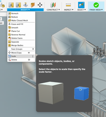

So you right click on the mesh n the viewport and select "edit" from the menu:
That brings you to the mesh workspace where you now scale the mesh to 1/25.4.
Once you click on "Finish mesh" you are placed back into the model environment and can convert the now properly scaled mesh into a BRep if you so desire.
