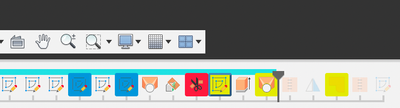

1. Whenever I edit a loft and add a profile to it, Fusion starts treating it as a new body as if the previous loft was deleted and a new one created. This means that all subsequent operations are broken. On the timeline it looks like this:
If you are not an expert, it can take 5-10 minutes to find all broken references and fix them. I've done it probably 200 times today alone. I'm sure you can imagine my feelings about this time investment 🙂 And yes, with practice it no longer takes 10 minutes, but since it's the same loft as before, maybe it's possible to prevent it from happening?
