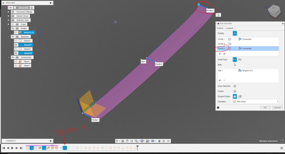

Here is one: Rails can not be tangent to profiles!
Tangent? i created the profiles using intersection points...
This happened when I adjusted the tail concave  shape by some 1mm, so my guess the problem should be on the tail side. If I change the same concave randomly to one side or the other, it starts working again. Sometimes I have a feeling Fusion was designed to drive people crazy.
Message 58 of 92
