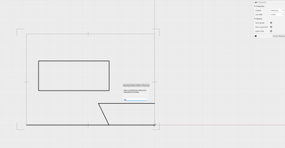

4.the template creation for drawings is not even close to a point where you can change them easily and simply. there it would be very helpful if you could draw lines and dimension them to create frames and title blocks.

what i mean with point 4 is for the complete Drawing Section,
When you start to create templates of your titel block it's give only 2 options,
first  in "Design" Section Create your Template what you want and export the sketch as DXF to import it in Drawing as Title Block.
second option is Draw rectangles without dimension what make no sense.
why is in the Drawing Section when you create a Title Block no full sketch function ? like Inventor ?
