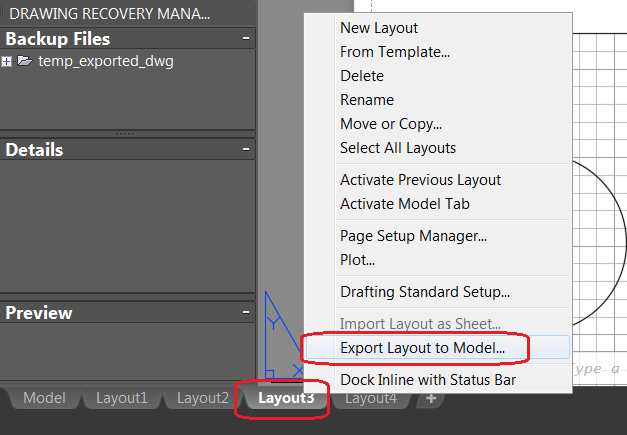

@AmishSolanki, current Fusion only import contents inside Model space, won't import contents from layout/paper spaces. One workaround is to "Export layout space to Model" in AutoCAD as below images shown, export the layout/paper space to Model (as a new dwg/dxf) file. Does this work for you?
