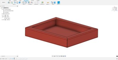

Scenario:
I design a a sheet metal pan in a 1 piece design:

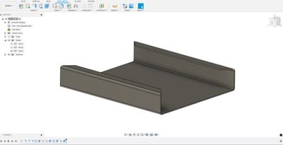

For manufacturing it would be better to make this a 3 piece design for better sheet utilization when laser cutting it. I ripped the radius and extended the edge for a weld fit up. Now there are 3 bodies but Fusion 360 will not create a flat pattern.
Is there a way to convert these 3 bodies now into components so flat patterns can be generated. If not could we get this capability on a future enhancement?

TheCADWhisperer
Model with standard tools.
Split it up.
Convert the three bodies to Sheet Metal Components.
jhackney1972
If you already have what you need as Sheet Metal Bodies, you can create Sheet Metal Components from them using the process outlined in this Blog Article and Video.
John Hackney, Retired
bryan5
Thank you @jhackney1972 this is the solution I was looking for in this scenario. You are a Fusion sheet metal wizard.
