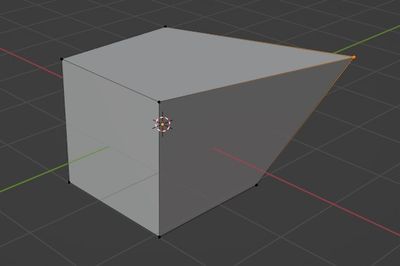

android111
Thanks - the reference image shows what I'm describing.
FWIW, no issues doing this in Rhino, though their brep/nurb manipulation philosophy is a bit different.

android111
Thanks Peter - Plasticity does not do it, which is part of what brought me here!
As noted - Blender does it effortlessly, though may result in wonky geometry.
That said - it's useful to be able to do this to prototype, even/especially to create a "guide" to use to properly build an object.
I'm not so concerned with the hardship a computer has to go through to figure out how to do it 😉

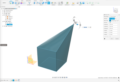

For this example, I created two sketches to represent the boundary of the box ("cube"), note that I removed all the constraints from the curves except for the coincident constraints at each adjacent line endpoint.  I know this will give me the freedom to move those pairs of points in coordinate space as I wish.
Then create two lofted faces (using the corresponding opposite curves for the inputs) for the inputs of the main lofted body of the box.  Note that Fusions modeling kernel will accept sketch profiles or surfaces/faces as inputs for lofts.  However, if you pull a sketch out of plane (i.e. one point of a rectangle is not on the sketch plane) the profile will fail and so will any subsequent features.
So I used the two surface bodies (Body1 and Body2) as input for the solid loft.
Hint: turn off the sketch visibility, when building the loft to make selecting the surface bodies easier)
Now turn on the visibility of the sketches and Move vertices to change the shape of the box
You now have a parametric box that modifies as you expect.  it is important to note that while it is parametric, it is nowhere close to being fully defined, this makes some designers and engineers uncomfortable proposing this workflow, but I've seen it used quite successfully for conceptual work.
